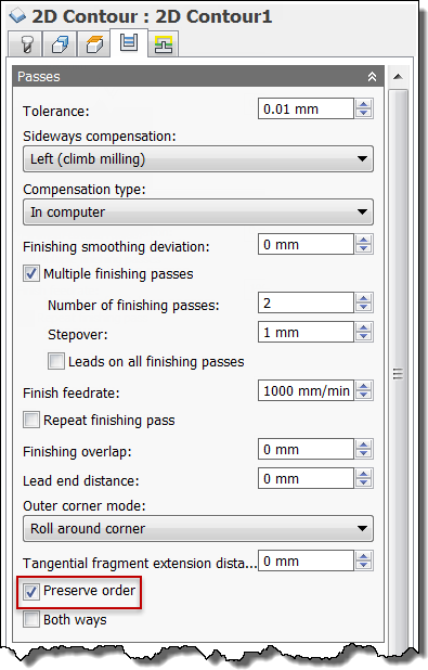

To manually control the ordering, select the individual contours in the order in which they should be machined and enable the Preserve order check box on the Passes tab.

The Preserve order option on the Passes tab
