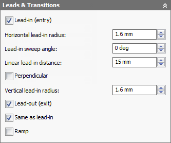

Make Leads Tangential
Change the Lead-in and Lead-out settings to use a 0 degree sweep. This will drop the horizontal lead in arc, and do only a linear lead, tangentially to the cutting pass. The vertical arc is retained.
2D Contour toolpath with 15 mm linear lead distance and 0° sweep angle

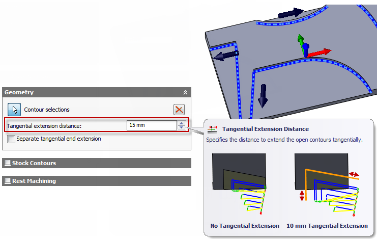

Use Tangential Extension
The Tangential extension distance setting provides a result similar to long linear leads, but allows you to retain the complete lead-in, including the horizontal arc, and the sweep angle.
In addition, this feature provides enhanced collision checking, which can be relevant especially when using multiple roughing passes.
Tangential extension distance set to 15 mm
The Separate tangential end extension option lets you specify separate tangential start and end extension values for 2D contours. Enable this option and define a different extension distance for use at the end of an open contour by entering a value for the Tangential end extension distance parameter.
Tangential extension distance set to 15 mm for the beginning, and 5 mm for the end of the open contour
