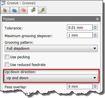

In the turning Groove strategy, the Up/down direction setting controls the direction of the finishing passes and can be either Up and down, Only down, or Only up.
The Groove Up/down direction setting

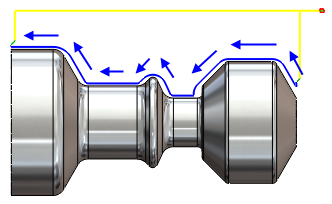

When using a grooving tool, it is often beneficial to use the Only down option. The following example shows the same toolpath in the three different cases.
Direction Up and down
