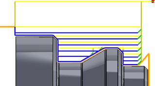

The Groove strategy is used for both roughing and finishing of the part using groove tools.

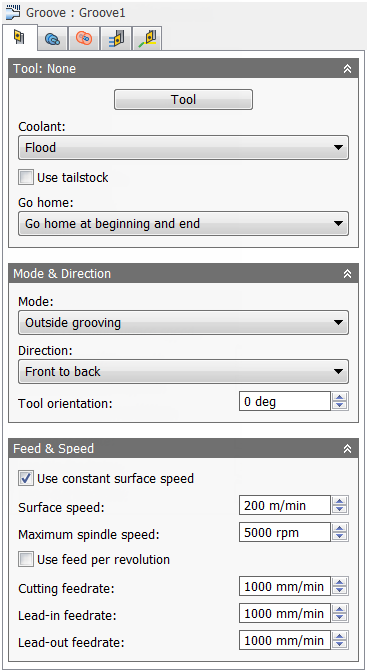

Tool tab settings
Coolant:
The type of coolant used with the tool.
Use tailstock
A tailstock is used to apply support to the longitudinal rotary axis of the workpiece being machined. This is particularly useful when the workpiece is relatively long and slender. Failing to use a tailstock can cause the workpiece to bend excessively while being cut and cause "chatter".
For this option to take effect, your machine needs a programmable tailstock and your post processor has to be configured to write the code your machine needs.
Once configured, you would typically see M21 (tailstock forward) at the beginning of the operation and M22 (tailstock backward) at the end with this option enabled.
Go home:
The Home position is a known Z value relative to the WCS and is defined within the Work Coordinate System (WCS) section on the Setup tab of the Setup strategy dialog.
You can force the tool to move to the Home position prior to starting the operation, or once the operation has finished. The tool will always pull out of the stock in the X axis until it reaches the Clearance height, then move to the Home position in the Z.
Mode:
Depending on the turning strategy (Profile or Groove), this setting determines whether the tool machines axially or radially, as well as the approach/retract direction.
Direction:
In conjunction with the turning mode, this setting determines the tool direction when cutting.
Tool orientation:
Use this option if your lathe turret has a programmable B axis. Your post processor will need to support posting from this value.
Tool orientation @ 45 degrees
Tool orientation @ 90 degrees
Use constant surface speed
Enable to automatically adjust the spindle speed to maintain a constant surface speed between the tool and the workpiece as the cutting diameter changes . Constant Surface Speed (CSS) is specified using G96 on most machines.
Note: For more information, see the Inventor HSM Help topic:About Turning Feeds & Speeds.
Spindle speed:
The rotational speed of the spindle.
Surface speed:
The spindle speed expressed as the speed of the tool on the surface.
Maximum spindle speed:
Specifies the maximum allowed spindle speed when using Constant Surface Speed (CSS).
Use feed per revolution
Enable to automatically adjust the feedrate based on the RPM of the spindle to maintain a constant chip speed.
Cutting feedrate:
Feed used in cutting moves.
Lead-in feedrate:
Feed used when leading in to a cutting move.
Lead-out feedrate:
Feed used when leading out from a cutting move.

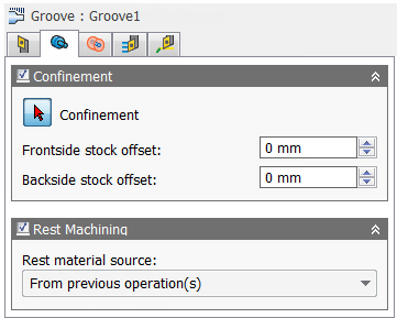

Geometry tab settings
Confinement
Toolpaths can be contained within a specific region using the Confinement button to select confinement boundaries. Confinement regions can be defined with a combination of edges, surfaces, or sketch points.
Frontside stock offset:
Specifies the distance to machine beyond the frontside of the model.
Negative Frontside Offset
Positive Frontside Offset
Note: This offset applies to the backside of the model or containment region, and can be used at the same time as a frontside offset.
Backside stock offset:
Specifies the distance to machine beyond the backside of the model.
Negative Backside Offset
Positive Backside Offset
Rest Machining
Specifies that only stock left after previous operations should be machined.
Disabled
Enabled
Rest material source:
Specifies the source from which the rest machining is to be calculated.

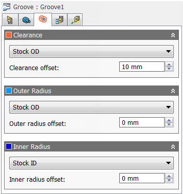

Radii tab settings

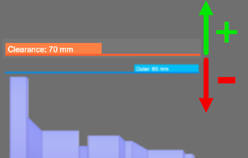

Clearance
Set this height to control the radius where the tool enters and exits the toolpath. The tool approaches and retracts from inside the stock along the Z axis (spindle axis) at this radial clearance offset. The value displayed on the orange tab represents its current radius relative to the setup axis.
Outer Clearance Radius
Note: The Clearance radius must be larger than, or equal to, the Outer radius to generate a valid toolpath.
Clearance offset:
Specifies the clearance offset value.
Outer Clearance Offset

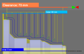

Outer Radius
Defines the radial confinement by limiting the outer radial range of the toolpath. You can choose from the following:
Outer Radius
Outer radius offset:
Specifies the outer radius offset value.
Inner Radius
Defines the radial confinement by limiting the inner radial range of the toolpath. You can choose from the following:
Inner Radius
Inner radius offset:
Specifies the inner radius offset value.

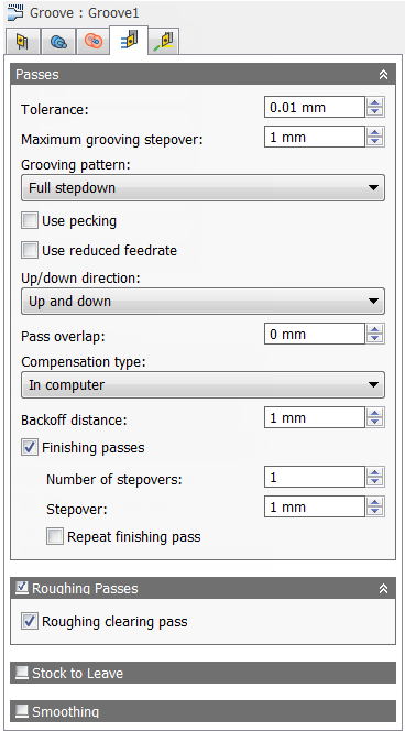

Passes tab settings
Tolerance:
The machining tolerance is the sum of the tolerances used for toolpath generation and geometry triangulation. Any additional filtering tolerances must be added to this tolerance to get the total tolerance.
Loose Tolerance .100
Tight Tolerance .001
CNC machine contouring motion is controlled using line G1 and arc G2 G3 commands. To accommodate this, CAM approximates spline and surface toolpaths by linearizing them; creating many short line segments to approximate the desired shape. How accurately the toolpath matches the desired shape depends largely on the number of lines used. More lines result in a toolpath that more closely approximates the nominal shape of the spline or surface.
Data Starving
It is tempting to always use very tight tolerances, but there are trade-offs including longer toolpath calculation times, large G-code files, and very short line moves. The first two are not much of a problem because Inventor HSM calculates very quickly and most modern controls have at least 1MB of RAM. However, short line moves, coupled with high feedrates, may result in a phenomenon known as data starving.
Data starving occurs when the control becomes so overwhelmed with data that it cannot keep up. CNC controls can only process a finite number of lines of code (blocks) per second. That can be as few as 40 blocks/second on older machines and 1,000 blocks/second or more on a newer machine like the Haas Automation control. Short line moves and high feedrates can force the processing rate beyond what the control can handle. When that happens, the machine must pause after each move and wait for the next servo command from the control.
Maximum grooving stepover:
Specifies the maximum grooving stepover.
Grooving pattern:
There are three grooving pattern options:
Use pecking
Enable to activate pecking options.
Pecking depth:
Specifies the pecking depth.
Pecking retract:
Specifies the pecking retract amount.
Use reduced feedrate
Enable to reduce the feed when grooving.
Reduced feed:
Specifies the reduced feedrate to be used at corners.
Up/down direction:
Offers three options to control the direction of the finishing passes.
Pass overlap:
Specifies the overlap distance used for passes split due to up/down machining.
Compensation type:
Specifies the compensation type.
Note: Control compensation (including Wear and Inverse wear) is only done on finishing passes.
Backoff distance:
Specifies the distance to back off from the stock before retracting.
Finishing passes
Enable to perform finishing passes using the side of the tool.
Note: This option is typically used when roughing and finishing is being done with the same tool.
Finishing passes on
Finishing passes off
Number of stepovers:
The number of roughing steps.
Stepover:
Specifies the horizontal stepover between passes. By default, this value is 95% of the cutter diameter less the tool corner radius.
Horizontal stepover
Repeat finishing pass
Enable to perform the final finishing pass twice to remove stock left due to tool deflection.
Roughing Passes
Enable to perform roughing passes.
Roughing clearing pass
Specifies that any cusps left by the roughing passes should be cleared. Enable this setting to avoid tool collision with leftover stock after the roughing passes at walls.
Note: This setting is particularly relevant when using the Up and down turning mode direction for the finishing passes that follow.
