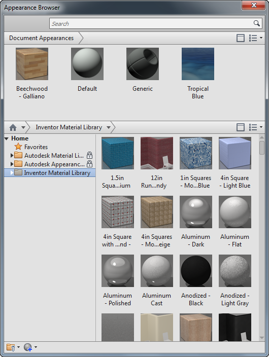

Appearance Browser
The Appearance Browser provides access to create and modify the appearance assets within the document, and to access the appearances located in the available libraries.
For example, the Appearance asset Generic includes the following properties:

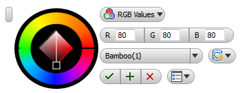

When applying a texture to a part, you can determine to what degree the texture color influences the part. With the Appearance Editor, you specify the Image Fade value. The Image Fade value is an opacity setting for the texture image. For example, combining a beige colored texture with an Image Fade value of 50 with a blue material color, results in an equal blend of the two colors.
If you want the texture to display on the part with exact fidelity to the texture color, set the Image Fade value to 100.
