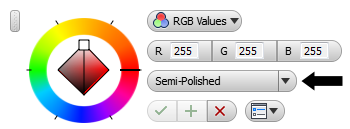

Document Appearance from a Feature or Face
  1. Edit the part.
  2. In the QAT, click Adjust .
  3. Using the in-canvas interface, select an Appearance.
