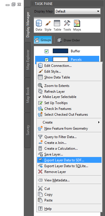

The map now displays only the parcels that lie within 100 feet of the road under construction. Select these parcels and save them to an SDF file so you can easily use this information again.
This exercise uses the AnalyzeMap1.dwg map you created and modified in the previous exercises.
To export the filtered parcels to an SDF file
Right-click the Parcels layer to export it.
For example, name this file ConstructionParcels to distinguish it from the other parcel file.
