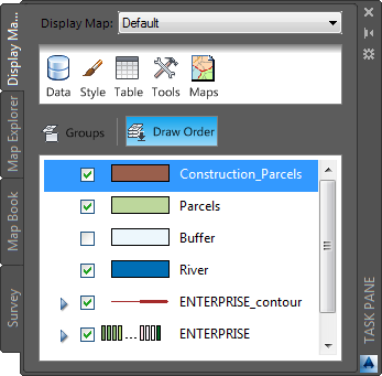

- In Display Manager, click Draw Order.
- Make sure the draw order looks like the illustration:
Click Draw Order to change how layers overlay each other.
