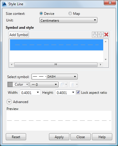

To style the roads in the map
  1. In Display Manager, select the Roads layer and click Style.
  2. In the Style Editor, click the Style entry.
  3. In the Style Line dialog box, change Color to dark gray.
  4. For Select Symbol, select a dashed pattern for the lines.
    Select a dark gray, dashed pattern for the roads.
  5. Click Apply and then Close.
  6. Close the Style Editor.
Your map now contains the styled surface and road layers.
