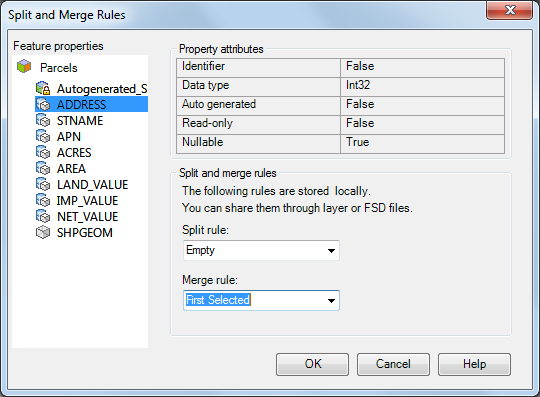

To create split/merge rules
Set rules for assigning properties after a split or merge operation.
Each property of the Parcels feature is listed under Feature Properties on the left. Two properties (Geom and FeatID) are generated by the data store, so you cannot set rules for them. If you select them, you can see the rules that the data store uses to create them.
If you split this parcel, you must specify the address number for each new parcel that is created.
If you merge multiple parcels into one, the new parcel uses the address number of the first parcel you select for the merge.
| Property | Split rule | Merge rule |
| ACRES | Proportional Based On Area2D (Geom) | Sum |
| APN | Copy | First Selected |
| AREA | Proportional Based On Area2D (Geom) | Sum |
| IMP_VALUE | Proportional Based On Area2D (Geom) | Sum |
| LAND_VALUE | Proportional Based On Area2D (Geom) | Sum |
| NET_VALUE | Proportional Based On Area2D (Geom) | Sum |
| PRIMARY_INDEX | Empty | First Selected |
| STNAME | Copy | First Selected |
