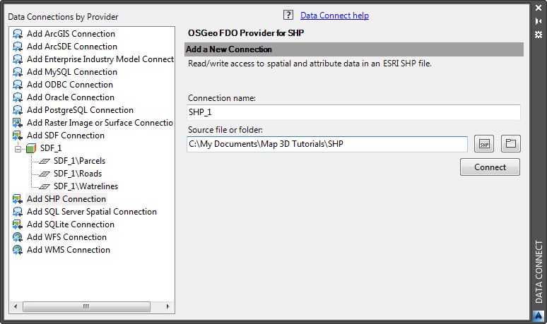

  5. On the left side of the Data Connect dialog box, click Add SHP Connection.
  6. On the right side of the Data Connect dialog box, click the folder icon (not the file icon). Select the folder you created and click OK.
    Click the folder icon next to Source File Or Folder.
    Click Connect and close the Data Connect window without adding anything to your map.
