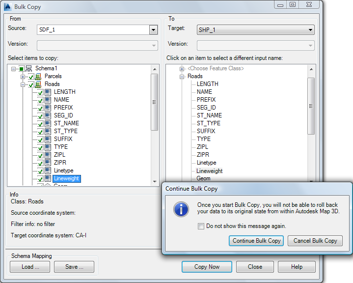

Copy the Roads layer from SDF format to SHP format using the Bulk Copy feature.
This exercise uses the map you created with the map2d.dwt template and modified in Exercise 1: Connect to a new SHP file folder.
To copy the Roads layer to SHP format
Bulk Copy.
Use Bulk Copy to convert data from one geospatial format to another.
If you see messages indicating that some property names are too long, shorten them and click Copy Now again.
Copy the data from SDF format to SHP format.
The data from the SDF file is copied to the new SHP file.
You copied the data from your SDF layers to SHP format.
