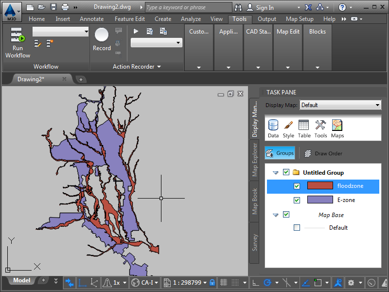

When you run the workflow, AutoCAD Map 3D lists the SDF files in the designated folder. Then it creates a Display Manager group to hold the layers that it creates. It connects to the SDF files in the designated folder. For each drawing in the designated folder, it connects, adds a layer to Display Manager, and moves the layers into the new group.
It saves the current map as a DWG file (converting all features to drawing objects). Then it saves each Display Manager layer to a .layer file, which can be shared with other AutoCAD Map 3D users or loaded into Autodesk Infrastructure Map Server .

    The layers are added to the map, as well as to the new Display Manager group. You are prompted for a name and location for the DWG file. The .layer files are saved to the location specified in the activity.
Where you are now
The layers are added to the map and are stored in the group you created.
