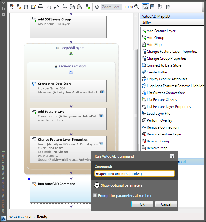

To complete the workflow definition, add the layers to a group and automate an AutoCAD command. Then save and test the workflow.
This exercise uses the workflow you modified in Exercise 1: Automate grouping layers.
Use a command line option to save the current map as a separate DWG file. You can run any command that you can enter on the command line.
Because this activity applies to the entire map, it does not have to loop. Therefore, you place it outside the LoopAddLayers activity
Add the Run AutoCAD Command activity just before the LoopSaveLayers activity. Enter the command name.
When you run the workflow, it prompts you for a location and file name for the DWG file. If you wanted to, you could specify those parameters as part of the workflow.

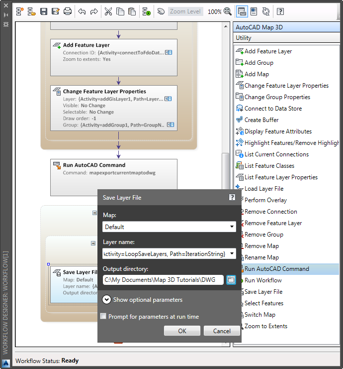

This activity saves each layer in the current map as a .layer file in the specified folder
Change the output directory for the Save Layer File activity.
