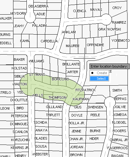

Use the buffer in a query to determine which parcels are within the construction zone represented by that buffer. Then, export those parcels to an SDF file for future use.
This exercise uses the AnalyzeMap1.dwg map you created and modified in the previous exercises.
To find the parcels in the construction zone
Polygon.
Click Select in the prompt. Click the buffer to select it as the location condition.
AutoCAD Map 3D filters the parcels to show only the ones that match the buffer query you defined.
Only the parcels that match the filter criteria are displayed in the map.
