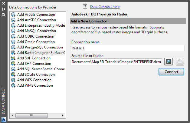

  2. In the Data Connect window, under Data Connections By Provider, click Add Raster Image Or Surface Connection and click next to Source File Or Folder.
  3. In the Open dialog box, browse to the ENTERPRISE.dem file, select it, and click Open.
    Look for this file where you copied the sample data.
    Connect to the surface file in the Data Connect window.
  4. In the Data Connect window, click Connect.

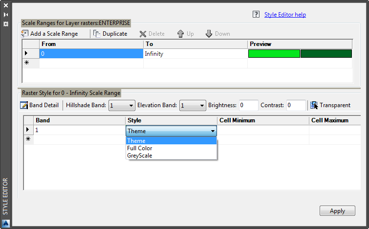

    • In the Style Editor, under Raster Style For 0 - Infinity Scale Range, click the down arrow in the Style entry. Select Theme (even if it is already selected).
      Click the first Style entry and select Theme.

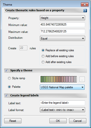

    • In the Theme dialog box, under Specify A Theme, click Palette and select USGS National Map Palette.
      Select the USGS National Map palette as the theme for the surface.

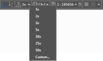

  4. Add exaggeration to show the differences in elevation more dramatically.
    • In the status bar below your map, click the down arrow next to Vertical Exaggeration.
    • Select 25x from the list.
      Set the Vertical Exaggeration to 25x.

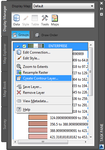

    • In Display Manager, right-click the surface layer and click Create Contour Layer.
      In Display Manager, right-click the surface layer to create contours.

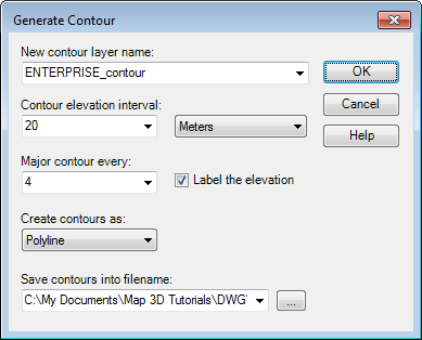

    • In the Generate Contour dialog box, in the Contour Elevation Interval list, select 20.
    • Leave the Units set to Meters.
    • In the Major Contour Every list, select 4. This setting makes every fourth contour line bold.
    • Select Label The Elevation. This labels the major (bold) contour lines only.
    • For Create Contour As, select polyline.
      The Generate Contour dialog box settings
    • Click OK.
