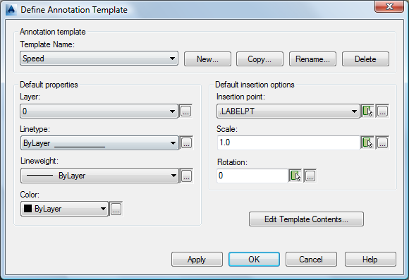

Define Template.
Click Edit Template Contents at the bottom right of the dialog box.

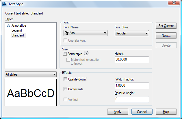

In the Block Editor, without clicking anywhere, type style.
Make the new text string the same size as the first one.
Click anywhere in the Block Editor and type dtext.
Use the Backspace and Delete keys to correct the text as needed.

Close Block Editor. The Define Annotation Template dialog box appears.
