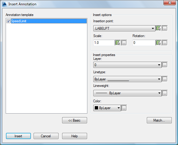

Use the annotation template you defined in the previous exercise to insert instances of the annotation into the drawing. Every drawing object that contains data for speed limit in the object data table will display its own speed limit value.
This exercise uses the map you edited in Exercise 1: Create an annotation template.
To attach annotation to drawing objects
For this exercise, select a few streets around the cloverleaf in the middle of town.
Select the streets around the cloverleaf.
Map Annotation
Insert.
Click the Annotate tab to see the Map Annotation options.
Any other annotation templates defined in the drawing would also be listed here.
Speed limit values in blue text are added next to each street, based on the object data associated with the street objects.
