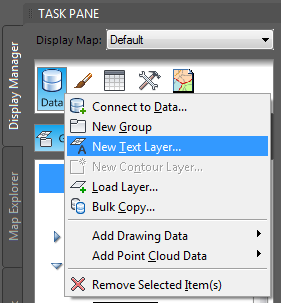

New Text Layer.
Create a text layer from the Display Manager.

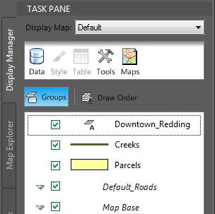

Call the text layer "Downtown Redding Text."
The new text layer is added to the Display Manager. The default layer name is Annotation.
Rename the text layer.
