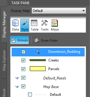

Notice that a new Text Layer tab appears in the ribbon when you select a text layer. You use this tab later when you check in your changes to the text layer.
Click the text layer and click Style.
These values provide the defaults for any text layer instances you add. You can override the defaults for an instance when you insert it.
