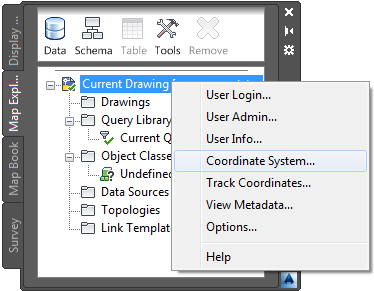

  3. Assign a coordinate system to the new map.
    • Switch to Map Explorer in the Task Pane.
    • Right-click the current drawing and click Coordinate System.
      You can also
    • For Code, enter ca-i and press Enter.
    • Click OK.
