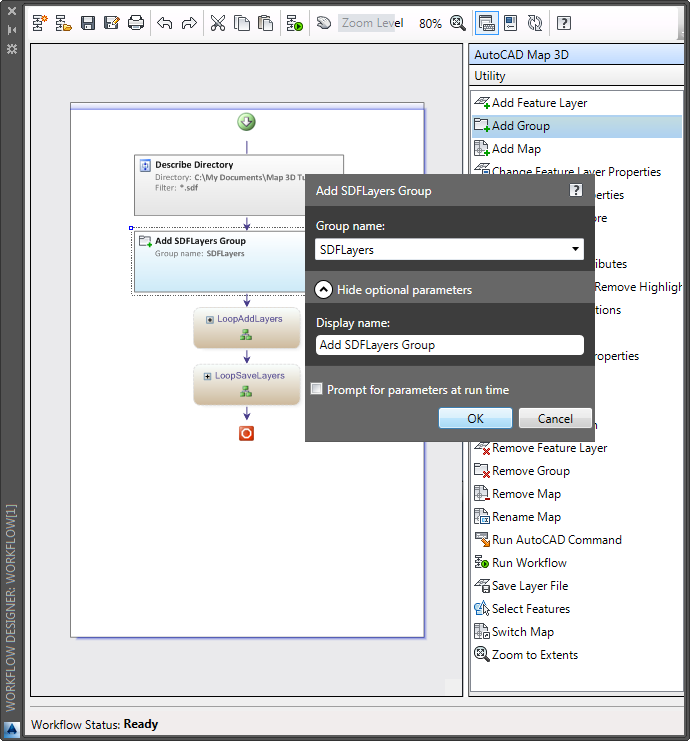

  6. Drag the Add Group activity from the activity panel and place it just before the LoopAddLayers activity. (Since you need only a single group, you place it outside the LoopAddLayers activity.)
    LoopAddLayers is a ForEach activity, which iterates a specified action on a specified collection of items. This type of activity is found in the Utility toolbox.
    In this case, the ForEach activity has been renamed “LoopAddLayers” to describe what it does. The activity examines each SDF file in the folder designated in the Expose Directory Contents activity. For each iteration, it connects to an SDF file and adds a feature layer to Display Manager.
    The new Add Group activity creates a group to hold the new layers. Since the LoopAddLayers activity adds layers to the group, the group must be created before the looped activity begins.
  7. Double-click the new Add Group activity to see its input editor. Set its parameters as follows and then click OK:
    • Name the new group SDFLayers.
    • Under Show Optional Parameters, name the activity Add SDFLayersGroup.
    Drag the Add Group activity just above the LoopAddLayers activity and change its parameters.

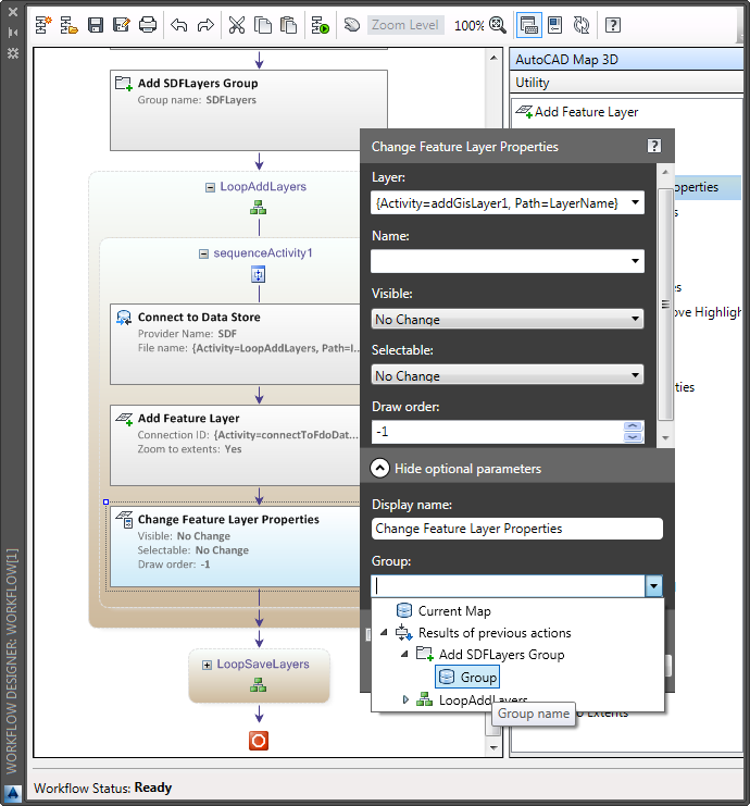

  9. Drag the Change Feature Layer Properties activity from the activity panel and place it inside the LoopAddLayers activity, under Create Layer.
    Because you want to change the Group property for each layer you add, place this activity inside the ForEach activity called “LoopAddLayers.”
  10. Double-click the new Change Feature Layer Properties activity. Set its parameters as follows and click OK:
    • For Layer, select the output of the Create Layer activity.
      By selecting the output of a previous activity, you are “binding” the current activity to its predecessor. The result of the previous activity does not yet exist in the current map. Binding allows you to specify a layer that will be created when the workflow is run.
      Click the down arrow next to the Layer field and, under Results Of Previous Actions, expand the Create Layer activity and select Layer.
    • For Group, select the output of the Add SDFLayers Group activity.
      Expand the Show Optional Parameters section. Click the down arrow next to the Group field and, under Results Of Previous Actions, expand the Add SDFLayers Group activity and select Group.
      Drag the Change Feature Layer Properties activity inside the LoopAddLayers activity and place it just after Create Layer. Change its parameters to specify the layers to change and the group for the layers.
    • Change the Display Name for the activity to Add SDF Layers to Group.
