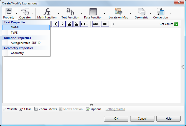

To add static text to the label
When you add a static text entry, surround it with single quotes. To include a space between the static text and the following property, put the space inside the closing single quote mark.
Replace the second property placeholder with NAME.
The expression now looks like this:
CONCAT ( 'Waterway: ' , NAME )
