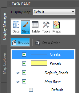

The Display Manager tab shows the layers in the current map.
Click the Creeks layer and then click Style.
