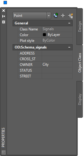

When you create an object using object classification, the new object inherits the basic properties for its object class with default values for those properties. You can change the values as needed.

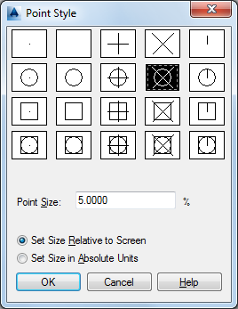

When you query in objects from a DWG file to a map, any styling information is lost. Since the points are not styled, you cannot see them in your new map. To see the signal points, assign a point style to your map.

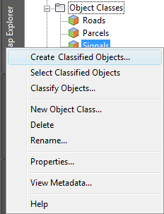

Once the signals are visible, you create a signal using the Signals object class.
To assign a point style to your map

Select a point style for the signals.
To create a Signals object
Right-click the appropriate object class to create an object in that class.
Use the Properties palette to view or change the properties for the new object.
