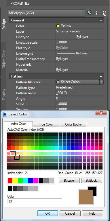

  4. Right-click any of the selected parcels and click Properties.
  5. In the Properties palette, click the Pattern Fill Color field (under Pattern on the Design tab) and choose a different color.
    Change the fill color of all objects in the Parcels object class using the Properties palette.
