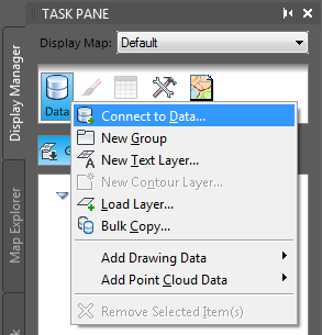

Click New in the Quick Access toolbar.
Connect To Data.

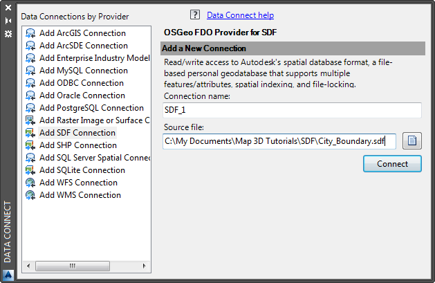

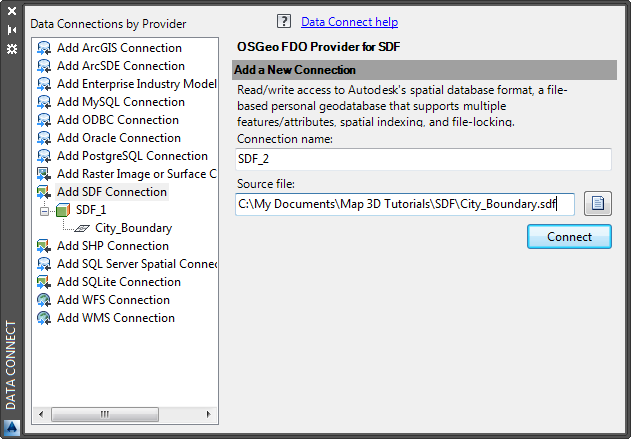

Connect to the data store containing the city boundaries of Redding.
Select the SDF provider and navigate to the sample file, CITY_BOUNDARY.SDF.
The text appears in the center of Redding. You can move and restyle the text. If you then check it in, you update the text layer data store. The new position and styling appear each time you use the layer.
