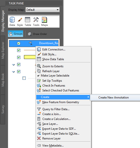

To add text to the layer
Create New Annotation.
Each annotation is one "text instance." You can add multiple text instances to a text layer. When you connect to the text layer later, all the text instances are inserted into your map.
Click where you want the text anchored.
Do not copy and paste the text. Type it directly into the dialog box.

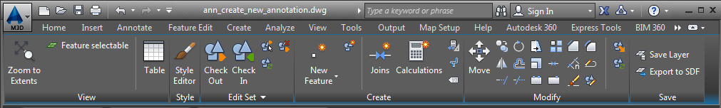

Check In.
Since the text layer is a data store, check in the changes you made so they become available in other maps.
If you change any text instance on this text layer (the contents or the formatting), check it in again. Checking in the data updates the data store with the latest edits.
