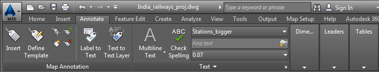

Map Annotation

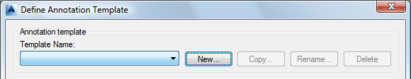

Define Template.
Click the Annotate tab in the ribbon to see the Map Annotation options.
Other options in this dialog box are unavailable because there is no annotation template yet. The dialog box redisplays when you create and save the annotation template.

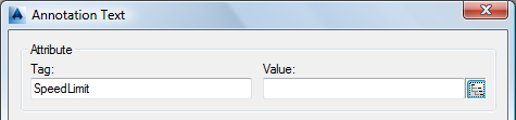

Annotation
Edit Annotation Text. You can also enter the command MAPANNTEXT.

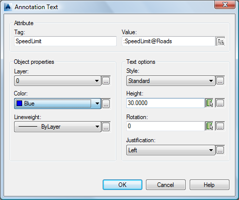

Press Enter in response to the prompt. The Annotation Text dialog box displays.

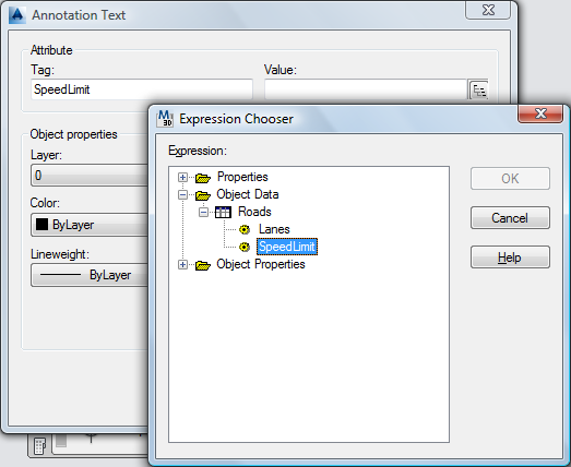

The button to the right of the Value field is the Expression Builder button.
Expand the Object Data nodes until you see SpeedLimit.
Make the annotation text blue and 30 units high.

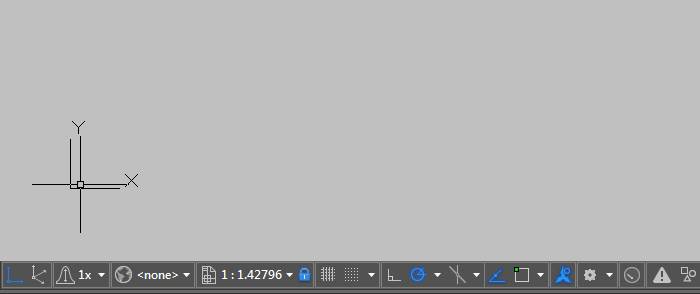

Check the location of the axis markers by hovering over their intersection point and looking at the lower left corner of the window.
0,0 represents the anchor point on the object. The annotation block is offset from the object according to how far away the block insertion point is from 0,0.
If the axis is not at 0,0, select it and drag it until it is.
Once the axis points are aligned at 0,0, click near, but not on, where the x and y axes meet. Then press Enter.

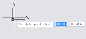

Click where the text of the annotation should start.
The actual speed limit for each road replaces the placeholder “SpeedLimit.”
