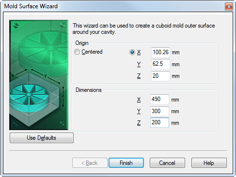

Create the Mold Boundary
In this task, you will use the Mold Surface Wizard to create a mold boundary.
  1. Click (Geometry tab > Create panel > Mold Surface).
  2. For the Origin, enter:
    • X = 100.26 mm
    • Y = 62.5 mm
    • Z = 20 mm
  3. For the Dimensions, enter:
    • X = 490 mm.
    • Y = 300 mm.
    • Z = 200 mm.
