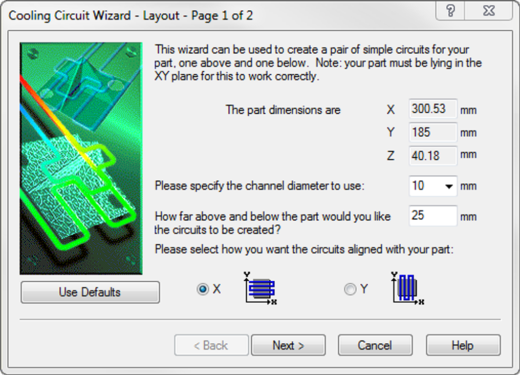

  1. Click (Geometry tab > Create panel > Cooling Circuit).
  2. Select 10 mm as the channel diameter.
  3. Enter 25 mm as the distance above and below the part.
  4. Select X as the alignment direction, then click Next.

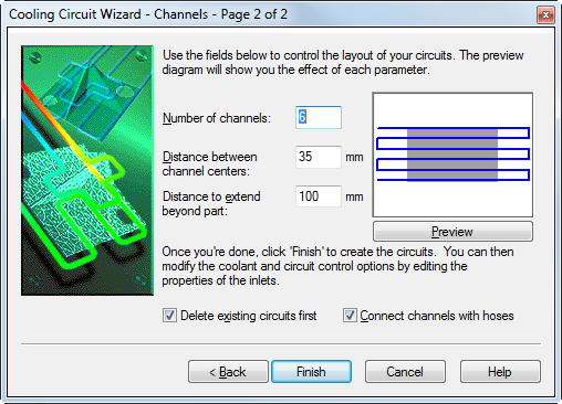

  5. Enter 6 mm as the number of channels.
  6. Enter 35 mm as the distance between channel centers.
  7. Enter 100 mm as the distance beyond the part.
  8. Click Connect channels with hoses.
  9. Click Preview to see the layout.
  10. Click Finish.
