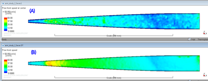

A new Flow front speed result has been created for Dual Domain and Midplane meshed models, and replaces the existing Flow front speed at center result.
The new Flow front speed result is a bulk, or average, result and is based on gradient of fill time instead of gradient of pressure. This result addresses the sometimes spotty appearance of the Flow front speed at center, as illustrated in the figure below, where (A) is the old Flow front speed at center result, and (B) is the new Flow front speed result.
Comparison between the old Flow front speed at center result and the new Flow front speed result
