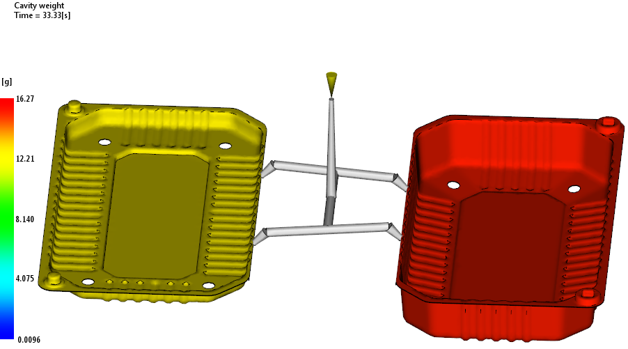

The cavity weight result shows you the calculated weight of each individual cavity in a multi-cavity mold.
This result is generated by default, even when there is only one cavity, for the following mesh types:
for the following molding processes:
- Thermoplastics injection molding
- Thermoplastics overmolding
- Co-injection molding
- Bi-injection molding
- Reactive molding
- Microchip encapsulation
- Thermoplastics microcellular injection molding
and for analysis sequences that include:
Use this result to check the balancing of the parts, and to confirm that the part weights conform to expectations.
