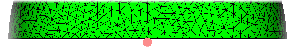

  1. Click the right face of the ViewCube to rotate the part to 90 -90 0. Zoom up so you can see the center of the part at the parting line.
  2. Click (Home tab > Molding Process Setup panel > Injection Locations).
  3. Click the part on the back end, in the center, on the parting line as shown.

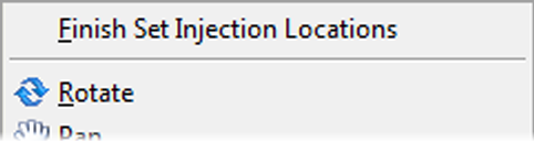

  4. Right click and select Finish Injection locations.
