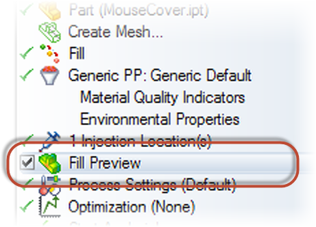

  4. Click Fill Preview in the Study Tasks List , on the left side of the Synergy Window
  5. Click (Results tab > Animation panel > Play) to animate the results.
  6. Stop the animation. Select the yellow injection location cone and drag it across the part. Watch the animation at the new location.
  7. Move the injection location around more if you wish.
  8. When done, deselect Fill Preview.

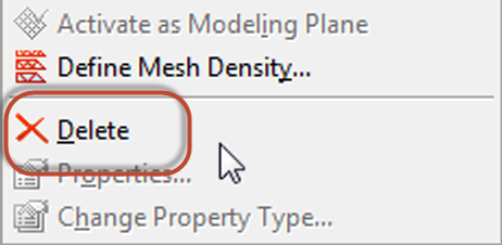

  9. Select all injection locations, right click, and select Delete.
  10. Right click and select Finish Injection locations. Ensure that there are no yellow cones left on the part.
