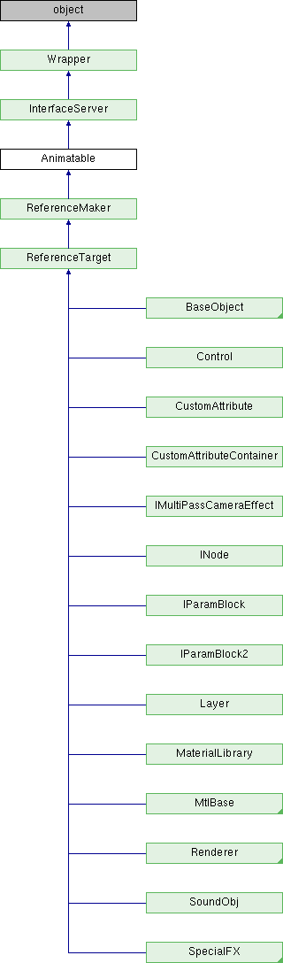

Animatable Class Reference
The base class for most scene entity and plugin types.
