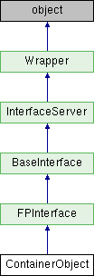

ContainerObject Class Reference
Access to container object functionality.
