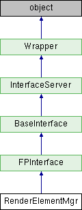

RenderElementMgr Class Reference
The interface for the Render Element Manager.
