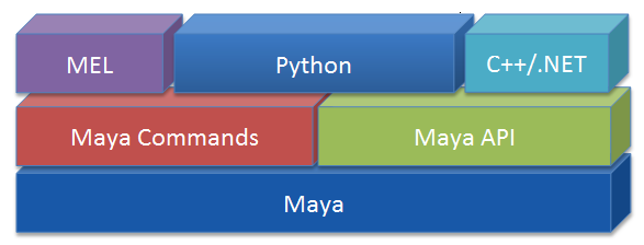

Autodesk® Maya® is an open product. This means that anyone outside of Autodesk can change Maya’s existing features or add entirely new features. There are two interfaces with which you can do this in Maya: via Maya commands or via the Maya API. Different language implementations are used for these two interfaces:
Write scripts using either of the following languages:
See the Scripting section in the Maya User Guide for an introduction to MEL and Python, and the Technical Documentation section for reference documentation on individual MEL/Python commands.
Write plug-ins using any of these 3 API's:
The Maya Developer Help provides a technical introduction to the Maya API, Maya Python API and Maya .NET API.
The Maya API is a C++ API that provides internal access to Maya and is available on the following platforms: Microsoft® Windows®, Linux®, and Apple® Mac OS® X. You can use the API to implement two types of code resources: plug-ins which extend the functionality of Maya, or stand-alones such as console applications which can access and manipulate a Maya model.
Plug-ins can be built in two ways:
The Maya Developer Kit provides example plug-ins that use the API. Many of the examples are provided with both C++ and Python source codes. To allow both versions to be loaded into Maya at the same time, the convention of prefixing commands and nodes with sp (for example, spHelix) is used for Python API 1.0 plug-ins. You are not required to follow this convention. Python API 2.0 developer kit examples are named with the prefix py (for example, pyBlindDoubleDataCmd).

As described earlier, there are two interfaces with which you can perform operations in Maya: via Maya commands or via the Maya API. In addition, you can use Python for both of these interfaces. You can use the Python API to create a plug-in, or merely to script. You only need to define a Python plug-in if you plan to extend Maya (for example, to add a new node type, or to add a new command type, and so forth). Otherwise you can use the API in your scripts as you would the maya.cmds module. See the widgetHierarchy.py example in the devkitBase\devkit\pythonScripts folder the Maya Developer Kit. This example imports the OpenMayaUI module and calls methods in the MQtUtil class. It is not a plug-in, and you can run the script directly using the execfile Python command.
The following are a couple of factors you may like to consider when deciding between whether to write a script or a plug-in, and whether to perform operations using the API or Maya commands:
Often, the Maya API is faster than Maya commands. The Maya API provides lower level access to Maya, and therefore more wide reaching access to Maya in general. Tasks such as iterating over a graph with filters is easier to execute via the Maya API than it is via Maya commands. In addition, if you were, for example, programming a paint tool that operates on many vertices simultaneously, it could be beneficial to use the Maya API for heavier datasets. If the speed in the Python implementation is not sufficient, you could then port the plug-in to C++.
To decide between writing a Python plug-in or a Python script (whether using API or commands), consider whether or not you need to extend Maya, or if you want the ability to load/unload your script.
