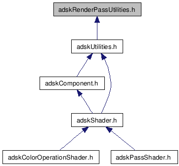

Include dependency graph for adskRenderPassUtilities.h:
This graph shows which files directly or indirectly include this file:
