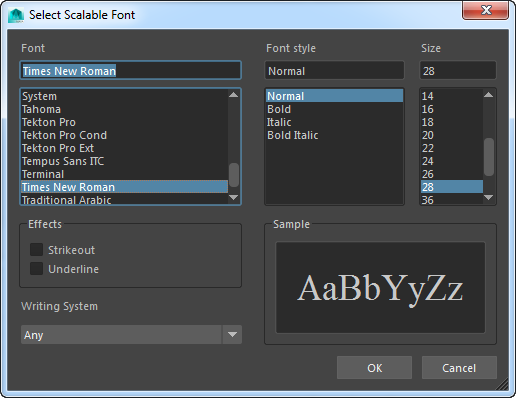

- Click the menu button next to the
Font field to open the
Select Scalable Font dialog box.
- Select a font, set its properties, and click OK.
Tip: Standard system fonts are available on all supported operating systems, meaning you can move a scene between platforms while maintaining the geometry of the text in your scene.

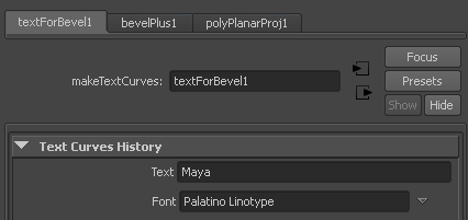

- There is also a textForBevel node in the history. The text attribute on this node allows you to edit the text string. For example, you can go to the textForBevel tab in the
Attribute Editor for the beveled text object and modify the text in the
Text Curves History section:
