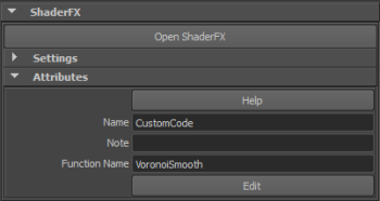

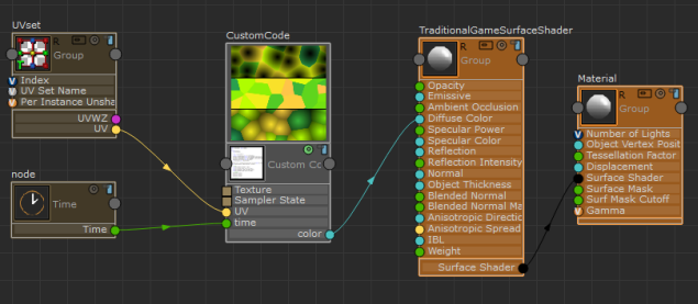

You can now use this code for your custom code node. Connect it as follows, and witness its animation in both the ShaderFX editor and in Viewport 2.0 OpenGL mode.

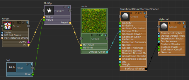

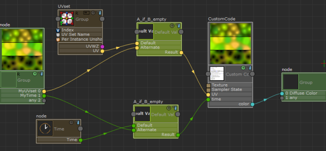

After you have created a Custom Code node using the code above, you can create a network such as the one below.
For more details about creating groups and using the Default Value node, see Provide alternative inputs to the group node and label the group node ports.
In this example, we provide a default UV set and a default time node, while allowing the user to provide an alternate UV set.
