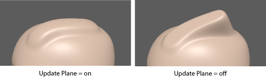

Specific to the Grab Tool. Makes the mesh follow the path of your stroke as you pull extensions out with a sweeping gesture. Stroke more slowly to extend the mesh further. When off, the Grab brush pulls extensions out along a straight line. This option is off by default.
Image courtesy of Andrei Cirdu
