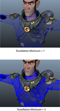

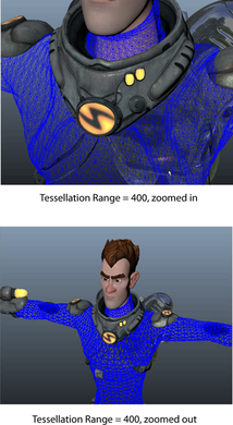

TessellationOFF: This is the default option and simply displays the mesh in the workspace without any tessellation.
TessellationON: This option uses shading level tessellation to provide a smoother model without the need for extra geometry.
WireFrame: This option provides a wireframe version of the tessellated mesh so that you can review the tessellation of the
TessellationON feature.

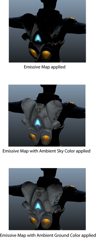

Ambient and Emissive
Emissive Map
- Enable this option and connect a file texture to
Emissive Map to apply an emissive texture that is bright like a light source. To stop using the texture, disable
Emissive Map.
Emissive Intensity
- Use this attribute to control the amount that the emissive map contributes to the shader.
- Ambient Sky Color /
Ambient Ground Color
- Use these options to brighten the object by simulating light coming from the ground or sky.
Ambient Occlusion Map
- Select this option to add ambient occlusion to your scene. Connect a pre-baked map that affects only ambient light in the shader.

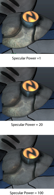

Specular Power
- Specular Power controls the shape of the specular highlight.

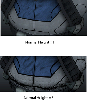

Normal Height
- Use the
Normal Height option to change the height of the bumps in the normal map texture.

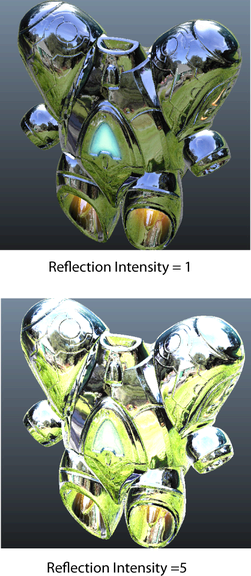

Reflection Intensity
- Use this slider to adjust the intensity of the reflection on your object.

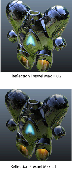

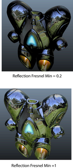

- Reflection Fresnel Min /
Reflection Fresnel Max
Use
Reflection Fresnel Min and
Reflection Fresnel Max to adjust the amount of reflection based on whether a face is parallel to or perpendicular to the camera.
Use
Reflection Fresnel Min to add more reflection to the faces of the object that are facing the camera.
Use
Reflection Fresnel Max to add more reflection to the faces of the object that are perpendicular to the camera.
These options work best for curved objects.

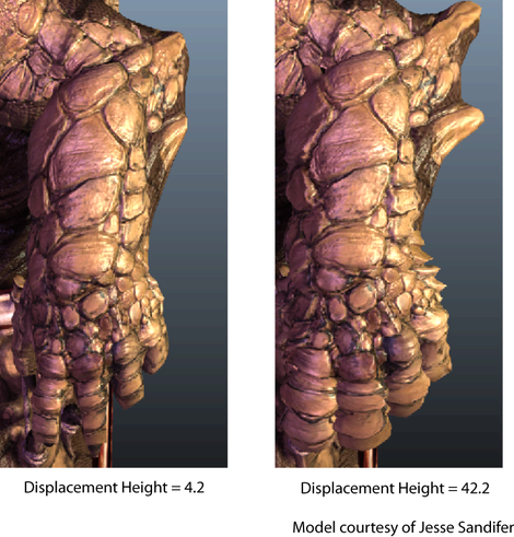

Displacement Height
- Use this attribute to scale your displacement.

Tessellation Range
- When you set this attribute, tessellation is controlled by the distance of the object from the camera.

Tessellation Minimum
Value of tessellation that is constant throughout the mesh. A value of 1 means no tessellation.
Increase the
Tessellation Minimum value to increase the resolution.

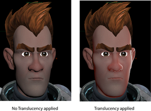

Translucency
Translucency
- The
Translucency feature simulates light passing through an object. For example, if simulating human skin, the skin becomes more red. Select this attribute to use the options below.
Note: Use these options to add translucency to your object. This option simulates light passing through the object to give it a more realistic look.
Thickness Mask
The
Thickness Mask is a texture you render to control the amount of light that passes through certain areas of the skin. For example, non-bony areas with thin skin like the nose would have a reddish color, since a lot of translucency is coming through. By contrast, bony areas would have a darker color in the thickness texture.
Light Translucent Distortion
Use this value to set the amount that the normal (per pixel) influences the translucency.
If set to 0, the translucency is uniform over the entire object.
If set to greater than 0, for example 0.5; the translucent effect is no longer uniform but is instead broken up and distorted based on the normal. The result appears more organic.

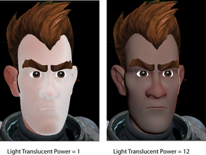

Light Translucent Power
- Use this attribute to change the focus or size of the translucent areas.

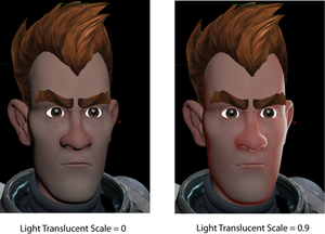

Light Translucent Scale
- Use this option to adjust the amount of translucency created by the light behind the object. When you adjust the slider to 0, there is no translucency in your object.
Translucent Minimum
- This attribute sets the amount of translucency that an object always has, even if there is no light behind it.
- Outer Translucent Color /
Medium Translucent Color
Inner Translucent Color
- Use these options to change the skin translucency color; for example, for a creature with different colored skin.
