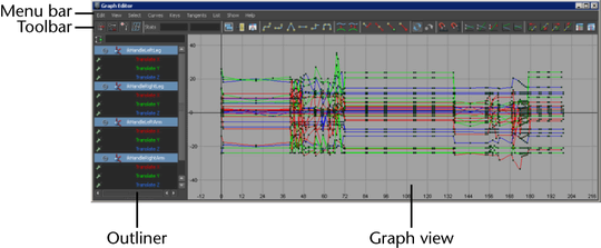

To open the Graph Editor:
The Graph Editor is a graphical representation of the animated attributes in your scene, shown as animation curves. The Graph Editor lets you manipulate animation curves and keys within a graph view of a scene.
The following table provides a brief overview of tasks using the Graph Editor:
