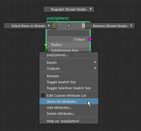

You can select the Show All Attributes option from the node marking menu to temporarily replace the full mode for a node with a listing of all of the attributes. The displaying of all of its attributes is only valid for this draw instance. If you regraph the node, or if you change the view mode of the node, you must re-select this option to see all of its attributes again. See Node Editor marking menus. For nodes that do not have an associated custom attribute list, you can also use the hotkey 4 to show all of its attributes.

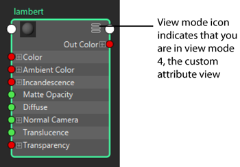

icon. You can also customize the list of attributes displayed for each node. To create a custom list of attributes, right-click the node and select Edit Custom Attribute List. After creating your custom attribute list, click
or hotkey 4 to display the selected node in its custom attribute view. See Customize a node attribute list in the Node Editor.
