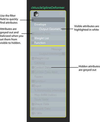

You can customize the list of attributes displayed for each node type.
This topic is applicable to both the Node Editor and the Hypershade.
To create a custom list of attributes, right-click the node and select Edit Custom Attribute List. You can then use view mode 4 to display your node in this custom attribute view.
The node switches to Edit mode and is highlighted with a yellow border. All visible attributes are highlighted in white. All hidden attributes are greyed out.
If you have never previously edited the attribute list for this node, then all the attributes for the node are listed, and all primary attributes are set as visible. In other words, the visible attributes list is the same as that of view mode 3.
If a custom list currently exists for this node, then the attributes are listed as they are saved in the list.
The node is drawn without any connection ports and all connections are drawn in grey. The node is also locked in place and you cannot make any connections to the node being edited. (If you try to make connections to another node in the Node Editor, you will exit out of Edit mode.)
