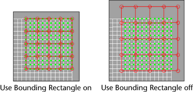

Manipulates the layout of UVs as a group by letting you create a lattice around the UVs for deformation purposes.
Specifies the number of columns for the current lattice manipulator. The minimum number of columns is 2 and maximum number is 8.
Specifies the number of rows for the current lattice manipulator. The minimum number of rows is 2 and the maximum number is 8.
Specifies the lattice manipulator's level of influence or falloff value.
When on, the current lattice manipulator cannot extend past the outer edge or boundary of the target geometry.

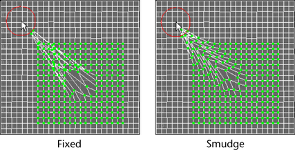

Moves the position of selected UVs and their neighboring UVs to a diminishing extent that is user defined.
Select the way the UVs follow the brush tool.
Moves the selected UVs in the direction of the UV Smudge Tool brush’s movements. UVs appear to follow or move with the brush. This setting moves UVs similar to the way the Soft Modification Tool moves vertices.
Drags or smudges UVs in the direction of the UV Smudge Tool brush’s movements.
Select the way that the UV movement falls off as the brush moves.
Moves UVs based on the distance they are from the UV Smudge Tool brush. A UV moves exponentially more the closer it is to the brush.
Moves UVs based on the distance they are from the UV Smudge Tool brush. A UV moves linearly more the closer it is to the brush.
Moves all UVs the same amount in the direction of the UV Smudge Tool brush’s movements.
