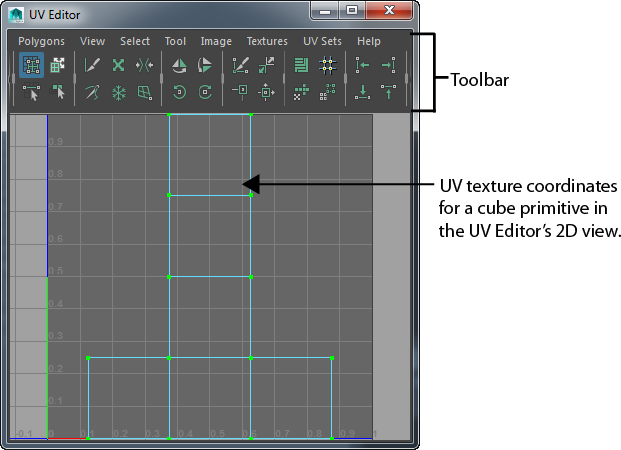

The UV Editor lets you view and interactively edit the UV texture coordinates for polygon, NURBS, and subdivision surfaces within a 2D view. You can access it from either Windows > UV Editor or the UV > UV Editor menu in the Modeling menu set. For more information on how UV shells are used, see the related topics below.
You can select, move, scale, and generally modify the UV topology for a surface very much like you work with other modeling tools within Maya. You can also view the image associated with the assigned texture map as a backdrop within the UV Editor and modify the UV layout to match as required.

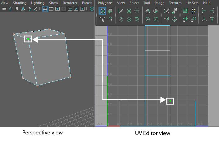

You can easily compare a 3D object to its 2D texture coordinates by right-clicking the layout shortcuts section of the Toolbox and selecting Persp / UV Editor. This layout displays the perspective view and the UV Editor simultaneously, allowing you to see how UVs within the 3D scene view pertain to those in the UV Editor's 2D view and vice versa.
