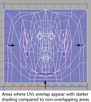

The Shade UVs feature lets you see whether any UVs or UV shells overlap when viewed in the UV Editor. You can also see the UV winding order on the selected UV shells. For more information on UV winding order see Display UV winding order.
When Shade UVs is turned on any selected UV shells appear shaded in a semitransparent way. Areas where shading appears more opaque indicate the regions of overlap. Overlapping UVs are often undesirable because any associated texture maps will also overlap on the related surface meshes.
To display overlapping UVs in the UV Editor
The selected UV shells update to a semitransparent shaded display. Areas where the UVs or UV shells overlap are visually apparent by the increased opacity of the shading in the overlapping regions.
